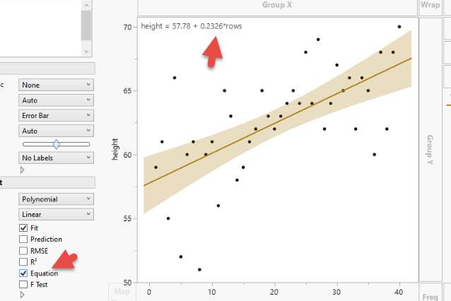

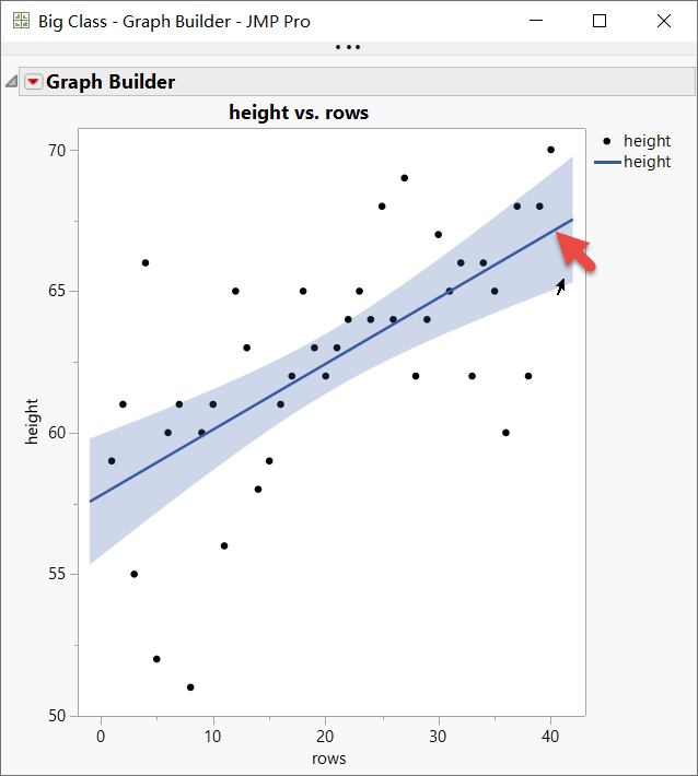

How can show the slope in the graph?
Thanks!
Graph Builder(
	Variables( X( Transform Column( "rows", Formula( Row() ) ) ), Y( :height ) ),
	Elements( Points( X, Y, Legend( 3 ) ), Line Of Fit( X, Y, Legend( 5 ) ) )
3 REPLIES 3

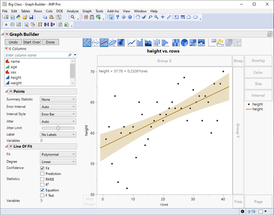

jthi
Re: How can show the slope in the graph?
What do you mean by slope in this case and where you wish to see it? You can for example enable equation for line of fit
