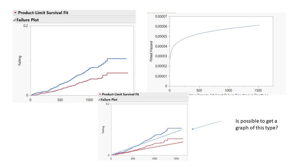

Hi, thanks for your interest.
I am not sure about the platform but i can explain what i am doing: from Analyse-->Reliability and Survival--> SUrvival.
In Y, time to event (my days up to the event), then Grouping: Treatment (Placebo vs Drug) and Censor the censor for the event (1, and 0). I then choose the Failing plot (but it would be similar the other way round for survival).
If you click on the red triangle (Product-Limit Survival Fit) you can choose competing causes which has been explained to me as "correcting for covariates". So i choose competing causes and then the Sex column of my subjects. I get a fitted Hazard (please see also Figure attaced but what i would actually like to have - if doable, is the first graph with 2 additional lines (which would be the "corrected" for sex failing plot- drug vs placebo.
peng_liu
Level VII
Re: How can i add "competing casuse lines" in a Kaplan- Meier plot
In your example, Sex, if it is what it is literally, is not a competing cause. An example of competing cause, in your example, might be cause of the event (let's say death). Died of a disease or an old age is a pair of competing causes.
I think what you need is the Proportional Hazards platform. And you should supply Treatment and Sex to Model Effects. And you can examine the effects of treatment, sex, etc.
