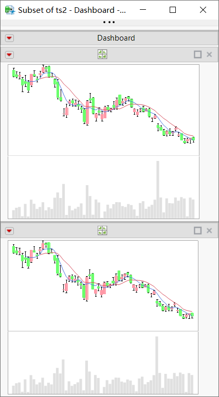

How can a complete large table be used to create an independent graph in the control panel without extracting subsets
Rather special stock charts. Thank you, experts.
For example, this stock data is processed by a script to generate multiple stock data, and the price data of each stock vary greatly.
It is difficult to obtain a perfect Graph using wrap in Graph Builder.
d0=Current Data Table();r=N Row(d0);
VV={"Date","Open","High","Low","Close","Volume"};
for(k=1,k<=4,k++,
d0<<Select Where(1);d0<<Select Columns(Eval(VV));d1=d0<<Subset(Output Table("ts"),Selected Rows(1),columns(Eval(VV)));
if(k==1,a="A",if(k==2,a="B";g=10,if(k==3,a="C";g=100,a="D")));
if(k>2,For(j=2,j<=NItems(VV)-1,j++,i=1;ca=VV[j];ar=d1<<GetAsMatrix(ca);for(i=1,i<=r,i++,ar[i,1]=round(ar[i,1]*g,0));d1[0,ca]=ar;));
ca="code";New Column(ca,Character,"Nominal");Current Data Table()[0,ca]= a;
m=5;ca="M"||char(m);New Column(ca);Column(ca)<<Formula( if(lag(code,m-1)==code,round(mean(close[Index(Row()-m+1,Row())]),2))) ;d1<<run formulas;Column(ca)<<deleteFormula;
m=10;ca="M"||char(m);New Column(ca);Column(ca)<<Formula( if(lag(code,m-1)==code,round(mean(close[Index(Row()-m+1,Row())]),2))) ;d1<<run formulas;Column(ca)<<deleteFormula;
if(k==1,dt=d1;dt<<setName("ts2");current data table()<<Go To(code);current data table()<<Move Selected Columns(To first);,current data table(dt);dt<<Concatenate(Data Table(d1),Append to first table);Close(d1,nosave));
How to use scripts to create independent graphs for each stock in the control panel?

dt=Current Data Table();p1=dt<< Graph Builder(Size(656,518),Show Control Panel(0),Show Legend(0),Show Title(0),Show Footer(0),Show X Axis(0),Show Y Axis(0),Show X Axis Title(0),Show Y Axis Title(0),Variables(X(Transform Column("Row",Formula(Row()))),Y(:High),Y(:Low,Position(1)),Y(:M5,Position(1),Side("Right")),Y(:M10,Position(1),Side("Right")),Y(:Volume)),Relative Sizes("Y",[243 166]),Elements(Position(1,1),Bar(X,Y(1),Y(2),Legend(7),Bar Style("Interval")),Line(X,Y(3),Y(4),Legend(6))),Elements(Position(1,2),Bar(X,Y,Legend(5))),SendToReport(Dispatch({},"Row",ScaleBox,{Min(-1),Max(64),Inc(10),Minor Ticks(0)}),Dispatch({},"High",ScaleBox,{Min(20),Max(56),Inc(10),Minor Ticks(1)}),Dispatch({},"M5",ScaleBox,{Min(20),Max(56),Inc(10),Minor Ticks(1)}),Dispatch({},"400",ScaleBox,{Legend Model(5,Properties(0,{Fill Color(32),Transparency(0.5)},Item ID("Volume",1)))}),Dispatch({},"Graph Builder",FrameBox,{Add Graphics Script(4,Description(""),/*KE*/bb=0.4;days=r-1;Pen Size(1);For(i=1,i<=N Rows(dt),i++,If(:Open[i]<=:Close[i],Pen Color(light red);Fill Color(light red);,Pen Color(light green);Fill Color(light green););Rect(i-bb,Max(:Open[i],:Close[i]),i+bb,Min(:Open[i],:Close[i]),1);Rect(i-bb,Max(:Open[i],:Close[i]),i+bb,Min(:Open[i],:Close[i]),0););)}),Dispatch({},"400",LegendBox,{Legend Position({7,[3],6,[0,1],5,[2]})})));(p1 << XPath("//OutlineBox[text() = 'Graph Builder']")) << Set Title("");

You could use Where in your graph builder call and then get it as a picture
Names Default To Here(1);
dt = open("$SAMPLE_DATA/Big Class.jmp");
Summarize(dt, groups = By(:sex));
lub = Lineup Box(N Col(2));
For Each({group}, groups,
	gb = dt << Graph Builder(
		Variables(X(:weight), Y(:height)),
		Elements(Points(X, Y, Legend(9)), Line Of Fit(X, Y, Legend(11))),
		Where(:sex == group),
		Invisible
	wait(0);
	lub << Append(Report(gb) << get picture);
	gb << Close Window;
nw = New Window("Report",
	lub
Write();
-Jarmo

Because stock charts have scripts, their effects are different、Thanks Experts!

Skip the picture part and just use Where?
gbs = {};
	gb_expr = Expr(dt << Graph Builder(
		Invisible
	lub << Append(gb = gb_expr);
	Insert Into(gbs, gb);
	lub
Show(gbs << Get Data Table);
Write();
-Jarmo
