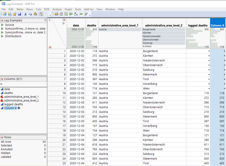

To make this more concrete, I've attached a simple example.  The lagged deaths column is what I want - but I'd like to be able to do it more simply or elegantly.

dale_lehman
Level VII
Re: How can I use a lag function applied by groups?
I might have guessed that txnelson would have a solution!  It isn't really more elegant or simpler than what I had, but it avoids the need to sort the data - which makes it considerably more flexible.  Thanks.
