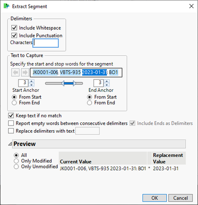

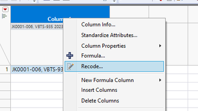

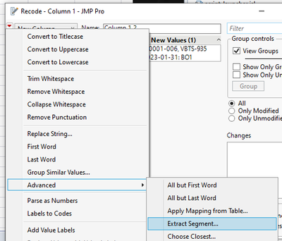

One thing I would also suggest is to explore Recode (right click on column header)
for example it has Extract Segments option (and many more)

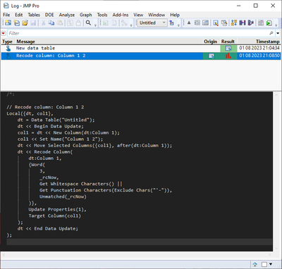

After you have split your column, you should be able to get script from Enhanced Log

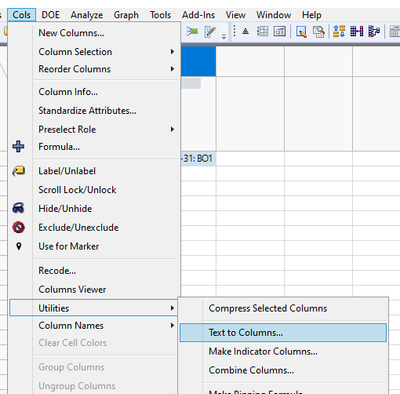

And Text To Columns which might help you to make the large problem into few smaller ones.
