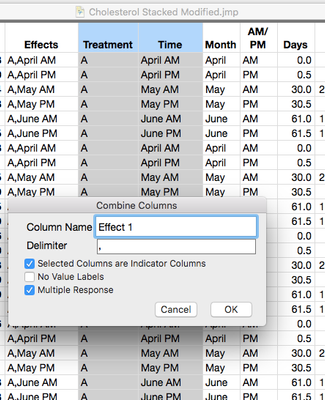

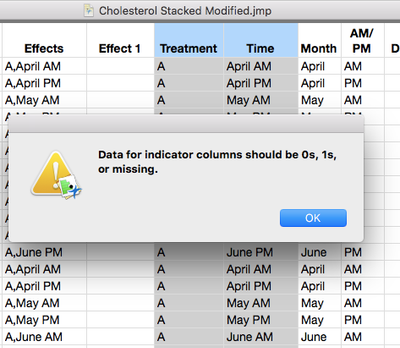

1. For testing how to combine columns, I tried to repeat your step and it didn't work. I followed the steps in the URL: file:///Applications/JMP%2014%20SW.app/Contents/Resources/en.lproj/JMPHelp/index.html#page/jmp%2FUG_EnterEditManageData_46.html, but an error messages was displayed (please, see the screenshots).

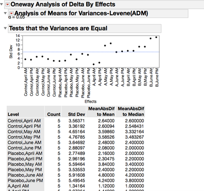

2. Regarding the min stdev and max stdev, do you refer to look at the "Test that the variance is equal" (screenshot)? I mean I need to compare each stdev given in that table to the "blue" stdev and verify if it exceds 3 stdev? By the way, I don't find the exact value of "blue" stdev in the Oneway ANOVA, but only that blue line.

To make the combined columns uncheck Indicators and multiple response.
From the attached scripts you should look at the data. From the Cholesterol Stacked data the variance is much larger for May and June for :Treatments levels A and B.   Also I look for equal variances for the first time period.  For a repeated measures, if one group's variance is much larger (or smaller) than the other groups' variance, this could be an indication of bias in the groups.
