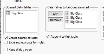

There should be no need to create any extra tables. You can append them together and close the tables you don't need (you should end up with just one data table).

Thank you for your reply, however I would like to keep the original table as is.
I analyse table A to produce some graphs then would like to combine with table B to produce a different set of graphs. I may want to go back to table A to do some more analysis.
Is there an alternative way to what you have suggested?

During first concatenation create new table and concatenate rest of data to that (this way you keep table 1 as it was and rest will be concatenated to the new table just created). Also if you leave Source column to your table, you can use Data filters to exclude other tables from the data.
