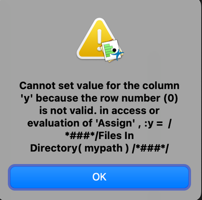

How can I loop through multiple csv files and select them base on specific file name?
Here is my code:
path = "/users/BOT/Test_files/";
Set File Search Path( mypath );
// filter out all csv files in the path that contains "Pass" &&  Not contains "Conditional_Pass" or "Fail" in file name
y = Files In Directory( mypath );
For( i = N Items( y ), i > 0, i--,
	If( (Ends With( y[i], ".csv" ) & Contains( y[i], "Pass" ) & Not( Contains( y[i], "Conditional_Pass" ) ) & Not( Contains( y[i], "Fail" ) )),
		Remove From( y, i )
n = N Items( y );
Keep getting below error as screenshot, is it because the Files In Directory() function being deprecated?
Funny thing is above codes used to work for JMP16, below error pops out after I upgrade to JMP17 yesterday.

I think you have a data table open with a column named Y. JSL is trying to use the table's column, which is not what you want. Either close the table, or change the name in either the table or the script, or use scoping to tell JMP which you mean.

You are most likely getting that error as you are removing same list you are looping over. For this type of filtering I would suggest using Filter Each instead of For loop.

please check path vs. mypath
besides that you could use Filter Each instead of the for loop:
//path = "/users/BOT/Test_files/";
mypath = "/users/BOT/Test_files/";
y = filter each({fn}, y, Ends With( fn, ".csv" ) & Contains( fn, "Pass" ) & Not( Contains( fn, "Conditional_Pass" ) ) & Not( Contains( fn, "Fail" ) ) )

Thanks Craige, yes I found my bug a day ago and solved it, just like your description.
