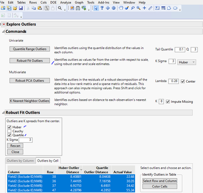

How can I identify outliers from a three sigmal control chart in JMP?

Very limited information given.
But, SPC is not used to identify outliers because it use Process Data to derive the control limits.
How about using "Analyze > Screening > Explore Outliers>" tool in JMP to identify the outliers?
For univariate data, you can use Quantile Range or Robust Fit Outliers to detect outliers
But if you want to specify the "sigma = 3", maybe you want to use Robust Fit Outliers using robust method.
