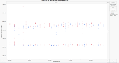

How can I get a line to show over points
How can I get the DSTV target lines to be on top of the VCC points?  I have tried Chat GPT, but everytime I do what it says I get the second image.  Using JMP 18.  Thanks!
3 REPLIES 3
jthi
Re: How can I get a line to show over points
I assume you want to combine both images. Generally, you would add both columns to same Y-axis, add line and points plots to same graph and then disable variables accordingly
In this case, points are from Steel Shipments and the line from Column 3
