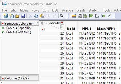

  1. When you select the function in the Formula Editor, when there are additional element available, a ^ is displayed in the formula, indicating that one can insert additional elements.txnelson_0-1698195005095.pngThe formula can be expanded by clicking on the txnelson_1-1698195120587.png icon at the top of the window. txnelson_2-1698195194413.png.  The formula now shows that a BY column can be specified.  The Col Mean() function will now calculate the mean separately for each of the BY columns different values. txnelson_3-1698195402359.png would calculate the Mean of column NPN1 for whatever value of Lot_id the specific row has.txnelson_4-1698196040403.png

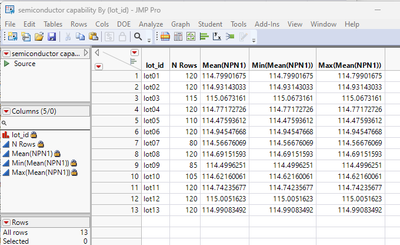

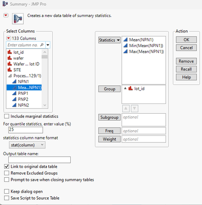

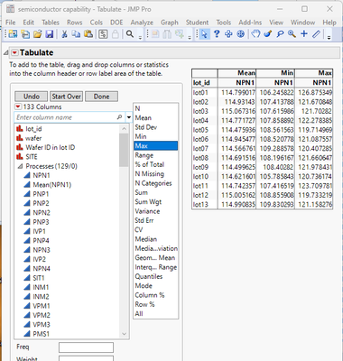

What you seem to be attempting to do, is to use/treat JMP as if it is Excel.  In Excel, one uses formulas to create the different outputs one wants.  While you can do that in JMP, it is typically much easier to use the built in platforms in JMP to get the answers you want. And rather than having the final goal to have all of your results at various places on your spreadsheet, JMP takes the approach of having the different results typically displayed in their own window.  Their location and linking to either by having them created from within a defined project, or by referencing them from the data table they were produced from.  Taking your specific issue, you might have either used the Summary Platform, or the Tabulate Platform to get the results you want.
Summary Platform
Tables=>Summary
Which produces a new data table
or
Analyze=>Tabulate
Which is an interactive, drag and drop application that allows you to develop a summary report
Summary Platform
Tables=>Summary
or
Analyze=>Tabulate
