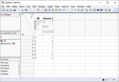

How can I count no of repetitive entry in a different column using formula.
I need to count no of test that were performed on particular SN. see atteched example.

You can use Col Cumulative Sum for this type of calculation in a formula
Col Cumulative Sum(1, :SN)

Re: How can I count no of repetitive entry in a different column using formula.
Thank you
