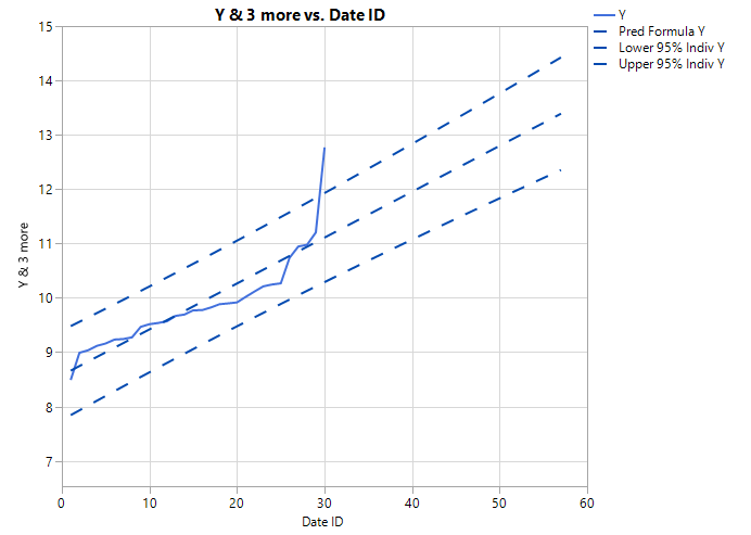

I think I can do the very simple and general example.  Suppose I had Fit a regression line using Fit Model in JMP to do this. Suppose I saved Predicted formula for the fit and I plotted the prediction formula versus the response "Date ID".   Suppose I added some number of future observations to predict on, I might get a graph like this if I plot the observed values, the prediction formula (from an OLS regression) and the upper and lower prediction interval band formulas (at 95% confidence, again for an OLS regression line).
Besides the new "Time Series Forecast"  Platform in JMP15 (which seems to be point and click, although I can't seem to save any sort of prediction formula there),  are there specific ways that data needs to be organized in JMP (especially time-series type data) to facilitate making dynamic predictions? (e.g. by adding N future observations as rows to the data table)?
