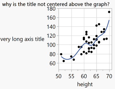

How can I center the Title above a Gaph builder Plot?

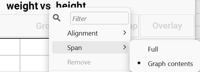

Right Click on the title -> Span -> Graph contents. This centers the title over just the graph, rather than the [graph and axis titles]. Does that fix the issue?

wonderful - thanks :)
Ah, it can be set via the preferences:
one of the few settings which I dare to change ...
