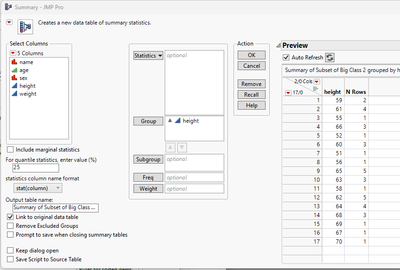

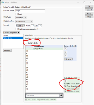

txnelson
Re: How can I arrange the unique values obtained from a column in the order they appear in the original column?
You can set the Value Order column property to be Row Order Level
And then when you use Tables=>Summary the new data table will output in the Row Order
Jim
