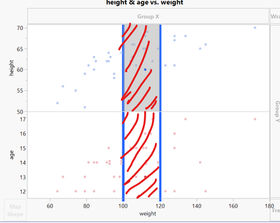

How can I annotate the background with different colors across different Y-axes?
The following JSL can annotate the region of 100 to 120 on the X-axis with a different color, but it cannot span across different Y-axes. How can I modify it to annotate different variable on Y-axes with different background colors for different variables?

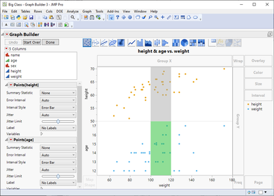

You have multiple FrameBoxes when you have multiple axis (or groups or wraps or pages), so you can for example add separate graphic script to each of them. Simplified version below
Names Default To Here(1);
gb = dt << Graph Builder(
	Variables(X(:weight), Y(:height), Y(:age)),
	Elements(Points(X, Y, Legend(3)))
rep = gb << report;
fbs = rep << XPath("//FrameBox");
fbs[1] << Add Graphics Script(
	Transparency(0.5);
	Fill Color("Gray");
	Rect(100, Y Origin() + Y Range(), 120, Y Origin(), 1);
fbs[2] << Add Graphics Script(
	Transparency(0.5);
	Fill Color("Green");
-Jarmo

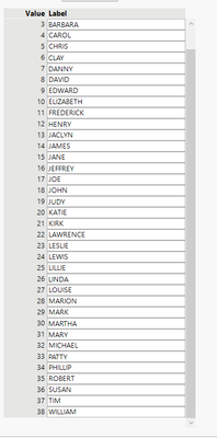

How can I use JSL to read the mapping of LABEL and VALUE in the current X-axis? I can't find a method to read the LABEL and corresponding VALUE on the current X-axis.
I would like to use MATCH on the text label to obtain the VALUE, and then highlight the specific range of values with a colored box.
jthi
Re: How can I annotate the background with different colors across different Y-axes?
If I remember correctly... (currently) easiest method is to read it from the data table using Summary table or Summarize.
-Jarmo

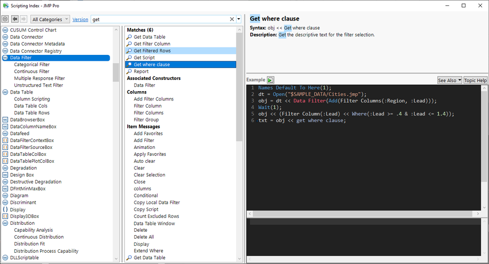

Show(ldf << get script, ldf << Get where clause, ldf << Get Filtered Rows);
Remember to check for the special case where no rows are being filtered
-Jarmo
