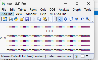

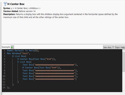

jthi
Re: How can objects be aligned with a central line?
You can use H/V List Box(align("center")) or H/V Center Box
Names Default To Here(1);
nw = New Window("Test",
	V List Box(
		align("center"),
		Text Box("Test Center alignment"),
		CB = Combo Box({"1", "2", "3", "4"})
Display Functions
-Jarmo
