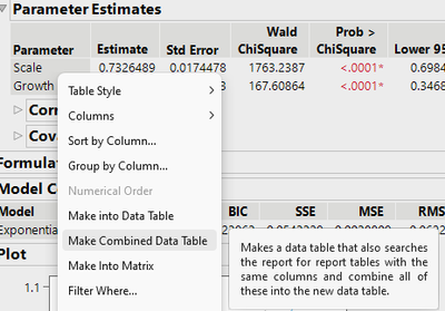

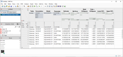

Right click on one of the result tables, make into combined data table
And from the resulting table, you can take the table script "Make Combined Data Table". This gives quite a good idea what you can do

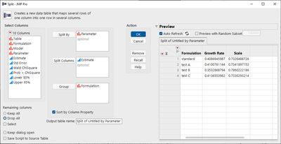

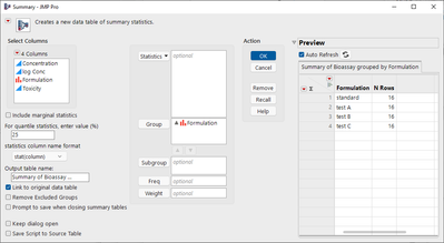

From the table you can then use different table platforms (such as summary, split and update) to create your final table
