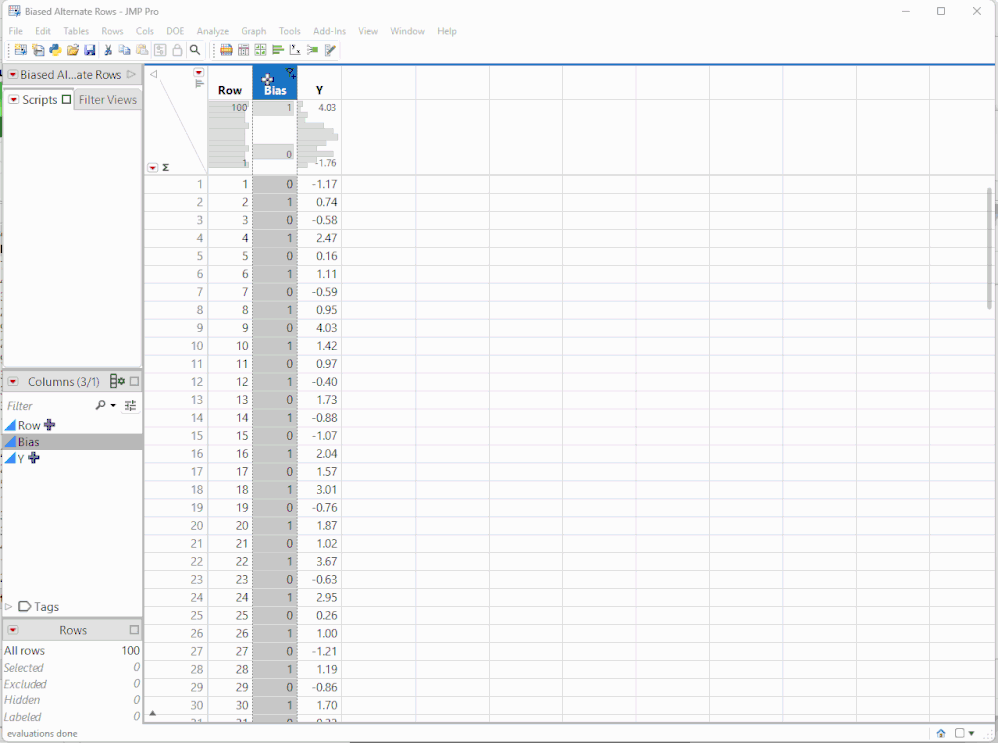

Re: Help performing a median polish
Hi Jed,
Thank you for your reply. Can you describe a bit more about what you are doing in this screenshot? I am not familiar with these options.
As for scripting, yes I understand the steps of the median polish, but as it is iterative, it would take some time for me to script/build in flexibility. Was hoping someone might help me build it or point me to a script that was already working!
Hi @amichaud,
Here's a quick breakdown of what's happening above:
  • Since you mentioned even vs odd rows, I created a column that alternates 0 and 1, called Bias.
  • Right-clicking on that Bias column, I selected New Formula Column > Group By. This doesn't create any columns, but sets the Bias column as a grouping column for any future formula columns.
  • Right-clicking the Y column, then selecting New Formula Column > Distributional > Center transforms the Y column to be centered around 0, iteratively for any given grouping variable. This means that the 0s and 1s in the Bias column will be transformed separately. This is really just a different way to de-bias the samples based on odd/even rows. You could also choose Distributional > Standardize to do this.
  • The graph is just trying to show this visually. The bottom graph has a different fit for each bias group, but the top graph has the same fit for both, since the bias was removed by centering.
Also, depending on what you're trying to do, you could also just include the Bias column as an effect in any model that you're creating. The Profiler will then let you see and interact with the effect, with no data changes needed. I attached an updated data table to show this.
