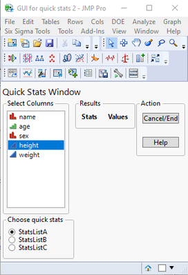

This is what I have so far:
Here is the list of things I'm having trouble with:
  1. The call for the Radio Box() lists the local variable name "StatsListA", etc. instead of actually listing out the stats that will be calculated. For example, the first radio button should have the following list behind it: Mean, Std Dev, Max, Min, Range, N. This should also be for the StatsListB and StatsListC (I haven't defined the C list yet). I'm not sure how to get it to evaluate the pre-defined list I make at the top of the JSL code. I'd prefer not to have to write out each and every item as I might want to change the items in the list and it's easier to change the local variable StatsListX instead of editing the Radio Box() call each time.
  2. Right now, I'd prefer to not list ALL columns, but just numeric. When I change the option in Col List Box() from All to Numeric (with or without ""), I get an empty list of columns. Can't figure out why this is happening, when it should list only the Numeric columns when I have that option defined.
  3. This is the hardest one I think: As mentioned before, I'd like the results in the Panel box "Results" to be updated with a column on the left "Stats" (which lists the statistics from StatsListX and the calculation results for those stats in the right column "Values". This should be updated with each click of a radio button. So if you were originally looking at :height, but wanted to look at :weight, you'd select :weight and then click on one of the radio buttons to get the relevant statistical summary. I tried following the Set Function example shown here, but have been unsuccessful (I do not know the Set Function call very well).DiedrichSchmidt_1-1632406884261.pngDiedrichSchmidt_1-1632406884261.png
  The Expr() for the MathA was intended to be called by closing the original window and opening a new one with the results, but after doing some more research in the JMP Discussions, I found that one can update fields within an existing window, which is how I prefer to approach this problem. So, I know that original coding at the top of my code is not the right code for what I intend to do.
  Any help on this is much appreciated.

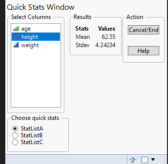

jthi
Re: Help Scripting an Interactive window that updates upon user choices
I did some quick testing and attached the script. It has possible ideas how you approach this, but might not be the best solutions.
1. Handled with Associative Arrays and Expressions.
2. Had to use some weird syntax for this ColListData = Col List Box(dt, All, <<Set Data Type("numeric"), Grouped, width(lbWidth), nLines(10))
3. Set Function is handling this with Evals.
The attached script will give the best idea how I approached this for now.
-Jarmo

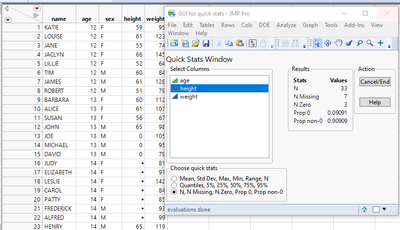

SDF1
Hi @jthi and @ian_jmp ,
  Thank you both for your great help! Thanks for the last two final hints @jthi , I was able to overcome the associative array alphabetical "issue". I do like the power of the AAs, I can see where they can come in handy, but I need a certain order to be maintained because of the users.
  I was able to make the changes with the lists suggestion and your suggestion for the Count Zero problem I had. Thanks! The code is working as expected, now I'll need to expand it for doing categorical columns and then survey my users to see what actual list of statistics they need.
  Thanks again for all your help! The working code (at least for numerical columns) is below.
Thanks!,
DS

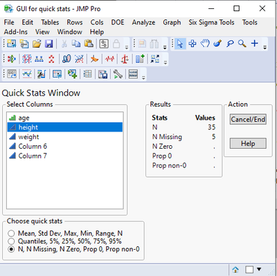

SDF1
  Thank you two so much for the fast feedback! Your suggestions worked great and I was able to make much more progress. Now I'm having issues with just two probably very simple things, I'm including the updated code below. Just as an FYI, I deleted some values in :height and added some zeroes in :height to test it
Issues:
  1. When it lists the statistics, it does them by alphabetical order, I'd like to maintain the order I have defined in my lists, is this possible?
  2. I'm trying to calculate the proportion zero and non-zero by first counting the number of zeroes. Unfortunately, it's not working quite right. I can put the summarize within an Expr(), but then I'm not able to define the associative array, and I don't get the right subsequent calculations. I'm sure there is an easier way to do this, but I couldn't find any direct command in JSL to count only zeros. I've entered 5 missing values, and 7 zero values manually. So, the prop-non-zero should be 0.8 and the prop-zero should be 0.2.

SDF1

jthi
After you get the script working mostly as you want, there are couple of visual things I would consider:
  1. The table size changes and makes the window "bounce" a bit
  2. If user has no column selected there will be an error
  3. If no datatables are open you could stop script execution and inform user
  4. If user changes the column in Col List Box, you should maybe either recalculate stats with the current selection of Radio Box OR set the table empty.
Couple of ideas:
  • For Results panel box. You can use Set Widths to prevent the table changing horizontal size and hidden placeholder String Col Box with pre-defined list size to prevent vertical size changes
  • Select Columns panel box. You can add Max Selected(1) to prevent user from selecting multiple columns.
  • Choose Quick Stats panel box. Some sort of "error-handling" if user has no column selected.
Complete script with some modifications:
View more...
