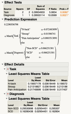

ps. I attached my model in the picture. To give an example of how I calculate a predicted value for
Task = N-back, Diagnosis = Non-SCD
I calculated y = 0.229-0.072+0.0662.

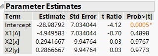

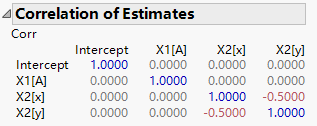

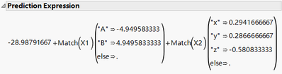

And here are "Parameter Estimates" and "Correlation of Estimates", the prediction expression, and LS Means of X1:
The prediction expression gives one some idea about the mathematical expression of the model, but not quite exact. The model looks like this
In which, b0 = -28.98792, b1 = -4.949583, b2 = 0.2941667, b3 = 0.286667, from the Parameter Estimates report.
The LS Mean of A is calculated by letting X1 = 1, X2 = 0, and X3 = 0 in the model. And three values plus the intercept form the x-vector in the following codes. Each element is the partial derivative of your prediction formula (a function of estimates) with respect to the corresponding parameter.
The following code calculates Std Error for LS Mean of A.

R = [1 0 0 0,
	0 1 0 0,
	0 0 1 -0.5,
	0 0 -0.5 1];
sqrt(x * s * R * s * transpose(x));
The values in "s" is from the Std Error column in the "Parameter Estimates". The matrix "R" is from the Correlation of Estimates. The product of "s*R*s" gives the covariance matrix of estimates. The product of "x*s*R*s*transpose(x)" gives the variance estimate of your prediction. The square root of the variance estimate give std error.
All other std errors are calculated similarly by using different x-vectors. E.g for B, x = [1 -1 0 0].

Are you trying to calculate the standard error of y = 0.229-0.072+0.0662?
Then none of the numbers in your screenshot give you that. Those means are marginal, e.g. mean of N-back is simply the mean of your Y of all observations whose Task = N-back, regardless what Diagnosis  is.
To find std err of your prediction, try Estimates > Custom Test.
