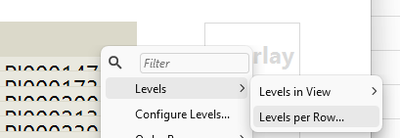

You can right click the 'header box' on the graph and go to Levels per Row to change the number
The levels per row will always be the same, you can't change the number shown in each row. If you think this is something important to have, you can add to the JMP Wish List.

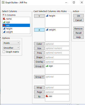

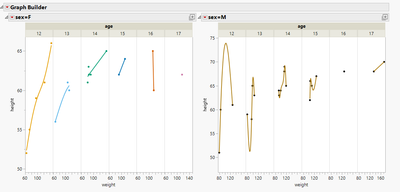

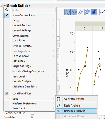

You can also try utilizing By. For Graph Builder it can be found from Redo > Relaunch Analysis.
This is quick way to create multiple (separate) Graph Builders based on grouping column and these can have different settings applied to them. They can also have some shared settings by broadcasting them from the outermost red triangle "Graph Builder" and you can do some layout changes from that red triangle, such as using Horizontal list of graph builders instead of vertical
