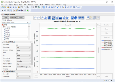

Sometimes I need to adjust the colors, but I would still like them to be the same as the default colors.  So for instance in 1 case I have 3 lines in my top graph (blue red green) and three lines in my bottom graph (purple orange....teal?).  And I want to change the 3 lines in the bottom graph to be the same as the top (blue red green).

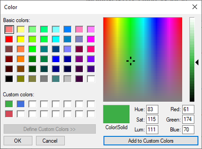

The problem is that from what I can tell the colors I can choose (with right click->line color) are not aligned with the JMP default palette.  I can't actually get the same color red.   It's either a little darker or a little lighter.

Not sure how easy to use this idea is, but you could go to Other from Line Color menu and set those colors to Custom Colors. You might have to set Blue three times, red twice and green once as they will overwrite colors.
Then you can get the colors from Custom Colors to other lines.

Yeah this was the method I was thinking of but really was hoping there was a more straightforward solution.    Are you able to extract the RGB H/S/L values for the default colors somehow?  Otherwise it's going to be a pretty painstaking process of guess and check
