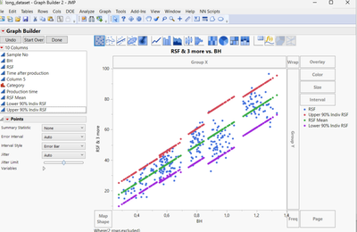

How can I have only dots only for the RSF variable and then lines for the rest variable that represent the mean values and the prediction interval? When I select a column and I click on the different types of plots at the top ribbon it changes the plotting type for all variables

Re: Graph builder - different types of visualization at the same plot
Graph Builder(
	Size( 534, 456 ),
	Show Control Panel( 0 ),
	Variables(
		X( :BH ),
		Y( :RSF ),
		Y( :Upper 90% Indiv RSF, Position( 1 ) ),
		Y( :RSF Mean, Position( 1 ) ),
		Y( :Lower 90% Indiv RSF, Position( 1 ) )
	Elements(
		Points( X, Y( 1 ), Legend( 18 ) ),
		Line( X, Y( 3 ), Legend( 19 ) ),
		Smoother( X, Y( 2 ), Y( 4 ), Legend( 20 ) )
	SendToReport(
		Dispatch(
			"Graph Builder",
			FrameBox,
			{Add Graphics Script( 7, Description( "" ), Empty() )}
Graph Builder(
	Size( 534, 456 ),
	Variables(
		X( :BH ),
		Y( :RSF ),
	Elements(
	SendToReport(
		Dispatch(
			"Graph Builder",
			FrameBox,
