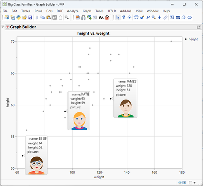

Here's an example pinning the hover labels.  Interesting that the selection is zero-based indexing.  May want to modify to handle no rows selected.
Names Default To Here( 1 );
dt = Open( "$SAMPLE_DATA/Big Class Families.jmp" );
dt << Select Rows( [1 5 7] );
pin_expr = {};
For Each( {v, i}, dt << Get Selected Rows,
	Insert Into(
		pin_expr,
		Eval(
			Eval Expr(
				{Add Pin Annotation(
					Seg( Marker Seg( 1 ) ),
					Index( Expr( v - 1 ) ),
					Index Row( Expr( v - 1 ) ),
					UniqueID( Expr( v - 1 ) )
Eval(
	Substitute(
			Expr(
				dt << Graph Builder(
					Size( 658, 556 ),
					Show Control Panel( 0 ),
					Variables( X( :weight ), Y( :height ) ),
					Elements( Points( X, Y, Legend( 5 ) ) ),
					SendToReport( Dispatch( {}, "Graph Builder", FrameBox, __pin_expr__ ) )
		Expr( __pin_expr__ ), Name Expr( pin_expr )

Re: [Graph builder] Batch pin the hover label for selected rows
Names Default To Here(1);
dt = open("$SAMPLE_DATA/Big Class.jmp");
dt << select rows([1, 10, 21, 30, 40]);
gb = dt << Graph Builder(
	Size(658, 556),
	Show Control Panel(0),
	Variables(X(:age), Y(:height)),
	Elements(Points(X, Y, Legend(3)))
pins = {};
gb << inval;
frame = Report(gb)[FrameBox(1)];
For Each({currow}, dt << Get Selected Rows,
	Eval(EvalExpr(
		Insert Into(pins, frame << Add Pin Annotation(
			Seg(Marker Seg(1)),
			Index(Expr(currow - 1)),
			Index Row(Expr(currow - 1)),
			UniqueID(Expr(currow - 1))
gb << update window;
wait(1); // demo purposes
pins << Delete;
-Jarmo

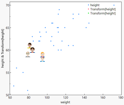

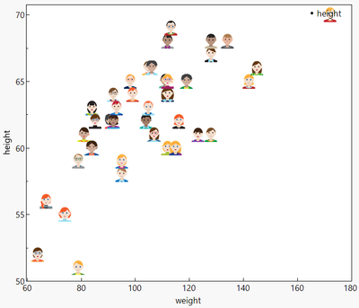

Does it need to be a hover label? Or could you use the picture as the symbol in your graph? For example, using the Big Class Families sample dataset:
If you only want pictures for selected rows, you could select them and Name Selection in Column, then use that Column to create a Transform column, like this:
// Open Data Table: Big Class Families.jmp
// → Data Table( "Big Class Families" )
// Name selection in column: Use Images
Data Table( "Big Class Families" ) << Clear Select <<
Select Rows( [1, 6, 14, 15, 16] ) <<
Name Selection in Column( Column Name( "Use Images" ), Selected( 1 ) );
Graph Builder(
	Transform Column( "Transform[height]", Formula( :height * :Use Images ) ),
	Size( 648, 551 ),
	Variables(
		X( :weight ),
		Y( :height ),
		Y( :"Transform[height]"n, Position( 1 ) )
	Elements(
		Points( X, Y( 1 ), Y( 2 ), Legend( 3 ) ),
		Points( X, Y( 2 ), Legend( 5 ), Set Shape Column( :picture ) )
I included the script so you can see the results with one click, but this can all be done within Graph Builder with no scripting. The key functionalities are Transform Columns and Set Shape Column.
Clanlope
Level III
Thanks for the reply! Using Set Shape Column works great, but it would be even better if the points could be displayed as well. This is definitely a convenient approach!
