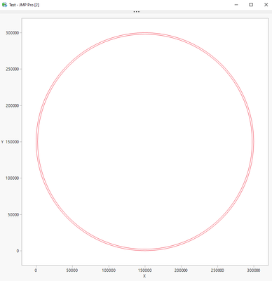

I am trying to draw a simple Wafermap which works fine with the following code.
However, when I substitute variables in for the numbers I get a missing reference error and can't for the life of me understand why this is happening. I need some JSL Expert Wisdom :)

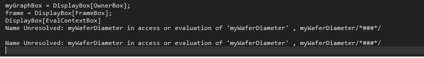

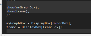

I am happily making references to the Frame Box as you can see from the log:
So, now lets substitute in some variables.
	frame << Add Graphics Script(penColor( "red" ); circle( {myWaferDiameter/2, myWaferDiameter/2}, myWaferDiameter/2));
	frame << Add Graphics Script(penColor( "red" ); circle( {myWaferDiameter/2, myWaferDiameter/2}, (myWaferDiameter/2) - myKeepOutZone));
And I get the following Error, suggesting I have lost the reference to my passed in variables when I try to add them to the frame box.
I'm stumped :)

The parameter WaferDiameter in the function MakeWaferMap only exists while the function is running. The formula supplied to <<addGraphicsScript will be unhappy with that variable later, when the graph redraws and tries to use it.
I also like the eval(evalexpr( ... expr() ... expr() ... ) ) method for casting the transient variables into stone, mostly because the JSL editor will still do all of the syntax checking for ( and ).
Craige

This works because variables defined inside the function are not, by default, local to that function. If you use delete symbols() before and show symbols() after running that script, you will find myWaferDiameter1 is now a global variable. Whenever writing functions I recommend using {defaultlocal} as the second argument for this reason, or to name all variables created in the function in that parameter so they are all local to that function call only.  If you use default local you will find the error re-appears since the variable no longer exists when the graph is drawn.  As @jthi points out, you can resolve this by evaluating the variable in the function context and then passing the value to the graph. As @Craige_Hales suggested, parameters to the function are also removed once the function finishes running, which is what caused the original problem.
So, to the original question from @thickey:
In the original example and when using a local variable in the function or as an argument to a function, the value myWaferDiameter exists in the function's local namespace until the function finishes running at which time it is removed from memory.  Since the graph is not drawn until after the function is finished running it cannot access the variable's value. To solve this, evaluate the variable in the context of the function.  I also prefer the method of doing this that @jthi described:
	Eval(EvalExpr(
			Pen Color("red");
			Circle({Expr(myWaferDiameter) / 2, Expr(myWaferDiameter) / 2}, Expr(myWaferDiameter) / 2);
When a variable is defined in the function that is a global variable, that variable exists until it is either deleted (using delete symbols() for example) or until JMP is restarted. So, when the window is drawn after the function finishes, it can still access the variable. This is a solution but it is more likely to cause errors in future code since different windows or scripts could interact with each other unexpectedly.
