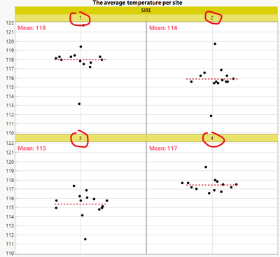

Hello,
I have created graphs for 4 sites
, but I would like to set the format for 1 / 2 / 3 / 4 and didn't find it.
where I can change it?

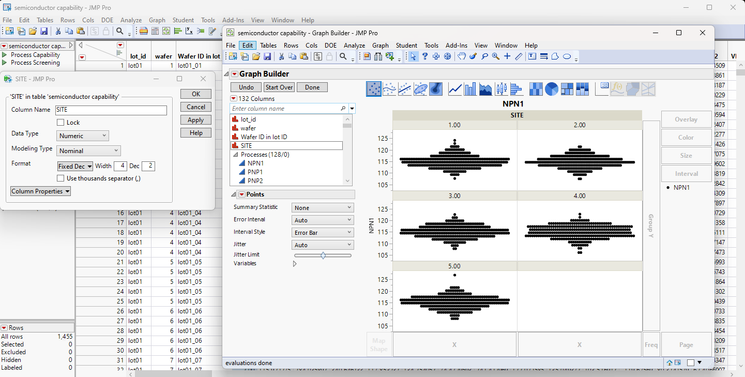

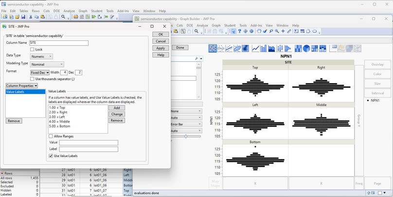

txnelson
Re: Graph Builder
Graph Builder uses the format that is specified for the column in the data table.
The Value Labels column property can also be set and Graph Builder will also honor those values.
Jim

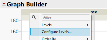

hogi
Level XIII
Re: Graph Builder
another way to change the displayed text is via Configure Labels:
On the other hand, if you want to change the font format, you have to change the font settings in the preferences - or vote for:
