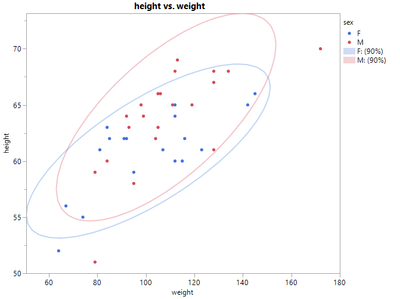

Hello everybody,
I would like to display Ellipse element in the graph builder but I would like to have only the contour colored and not the full ellipse.

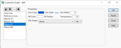

I found a solution using the Customize menu and modifying the Line Color property. However if there are several groups (using the overlay drop zone) it means that every ellipse need to be modified one by one.
Is there a faster way to do that? If possible without using JSL?
Here is an example using the Big Class data table:
Thanks in advance for your inputs!

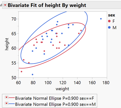

You can achieve this more easily in Fit Y by X though. From the red triangle menu you will need to select Group By... to specify the grouping variable. Then select Density Elipse. Then right-click on the plot and select Row Legend to colour by your grouping variable.
