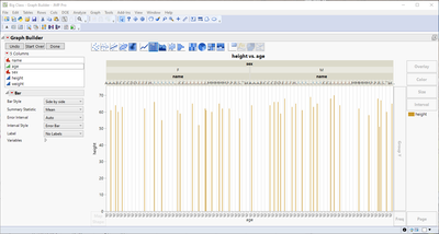

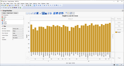

jthi
Re: Graph Builder - How to Nest Group X Variables?
Also, why you cannot plot with serialnr if you use only X-axis? I can go from this
to this by moving my x groups to x-axis
-Jarmo
HarriBradbeer
Level II
Thanks  jthi, your second solution worked well once I had changed the serial number from continuous to ordinal.
