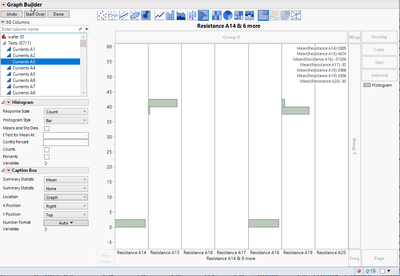

I am trying to add summary stats to the axis of the graph builder using the caption box in JMP 17, but it doesn't seem to work. Is there something I am missing?
Caption box adds mean text annotation on the graph but

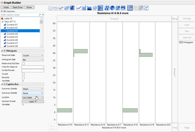

If I select the location on axis, it doesn't display anything

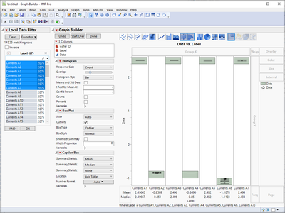

I think you should contact support regarding this. Most likely bug or oversight with the new feature implemented in JMP17. If you don't have too much data, you could try if you can do this when using stacked data table
