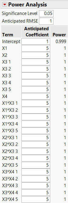

Important considerations for the power are the number of runs and the actual design. You did not state either, so I created a design for the same factors and model using the default number of runs (25). The power in this case is better than what you showed while using the same anticipated coefficients.
I am not sure what you expected for the relative prediction variance in this case.
