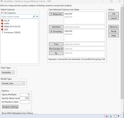

@txnelson But how to get script ... when variability chart selection  window opens then i want to get script after user selects "OK" button in that screen
i want to capture variability chart script after user selects OK in this screen
dt = Open( "$SAMPLE_DATA/semiconductor capability.jmp" );
obj = dt << Variability Chart();
// I want to get Script after User clicks OK How to do that

I am not aware of anyway to capture the script prior to actually running the platform.  Also, JMP JSL will not pause a script as the user enters the information into the Variability Chart dialog screen.
This snippet of code shows that the line following the call for the Variability Chart is run regardless of the status of the dialog box.
variability chart();
show("code after variability chart invocation")
This is why I suggested that since the Variability Chart dialog box is limited and building your own version of it is very possible in JSL, and it will give you the control you need.
