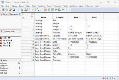

I am not aware of a report like you have suggested.  However, here is a simple script that might give you a start on developing ove.
Names Default To Here( 1 );
dt = New Table( "Table of Contents",
	New Column( "Table", character ),
	New Column( "Variable", character ),
	New Column( "Row 1", character ),
	New Column( "Row 2", character )
table = 1;
While( Try( Data Table( table ), "" ) != "",
	tableName = Data Table( table ) << get name;
	colNames = Data Table( table ) << get column names( string );
	If( tableName != "Table of Contents",
		For Each( {col}, colNames,
			dt << add rows( 1 );
			dt:Table[N Rows( dt )] = tableName;
			dt:Variable[N Rows( dt )] = col;
			If( N Rows( Data Table( table ) ) >= 1,
				dt:Row 1[N Rows( dt )] = Char( Column( Data Table( table ), col )[1] )
			If( N Rows( Data Table( table ) ) >= 2,
				dt:Row 2[N Rows( dt )] = Char( Column( Data Table( table ), col )[2] )
	table++;

Dear @txnelson , I have never scripted before. As such I cannot understand this script by reading it. However, when I paste it in and run it, I see that it gives me the summary table I wanted taking the data from every table I have currently open in JUMP. Is that correct?  If so, it is wonderful. All I need now is to open all the tables in my database. We only have 80 so it shouldn't be that bad. In sum, please answer:
1) Am I correct about what that script does, and
2) Do you know how to open all the tables in a database? If not, I can either find it in help or open another chat/ticket.
Thanks again.
txnelson
Re: Generate a report of database schema and sample data from each table
  1. You are correct.
