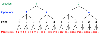

Hi,
I am running a Gage R&R study with 2 factors (Operator and Location), 3 different parts and 3 repetition per part. Operator and Location are nested. This means each location has 2 different operators but the parts are the same. This mean that parts has been moved from one location to the other to be tested by different operators. What option should I use? I would say it is nested then crossed since operator and location are nested but sample and operator with location is crossed. Am I right?

statman
Re: Gage R&R: Nested vs Crossed vs Nested Then Crossed vs Crossed then Nested
First welcome to the community.  You are correct, Operator is nested in Location, Operator and parts are crossed and measurements are nested in Op/Parts.
