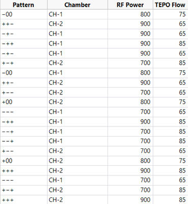

Initially, I have designed the following experiment using full factorial - 3 factor (2 continuous + 1 categorical) - process chamber being the categorical factor.
For the process of concern, it is already known that there will be chamber-to-chamber variation, but all chambers must be operable within a certain specification limit. Hence, the initial decision to include the chamber as categorical parameter.
In total there were 20 runs. The experiment has been performed and data have been collected.

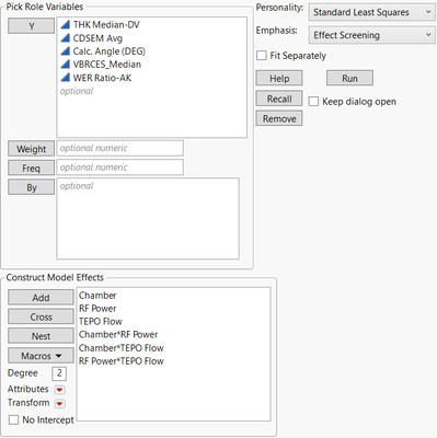

1. Would be better if Full factorial with blocking being used in the first place, since the chamber can be considered as random effect? If yes, then i'm screwed. :(
2. Is there any other way to use the existing data collected to properly analyze the data?

It seems then that the model that you show in your first post with all main effects and interactions as fixed effects will be appropriate.
You will be able to find out if there are significant interaction effects between your continuous factors and Chamber. If there are, you should be able to find settings of the continuous factors that minimise the difference between the two chambers.
Of course, understanding how this then applies to all your chambers is a different matter as you have not tested them. Perhaps you can use your prior knowledge about chamber variation to help you with this. You will need to think about how representative these 2 chambers are of the range of the 12 chambers. And you might carry out additional runs with different chambers to test your predictions.
...There is a lot to consider for your next steps but analysing your current experiment with the fixed effects model will be a good start.
