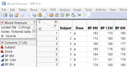

Given a simple Blood Pressure data table (This is subset of the Blood Pressure data table in the JMP Example tables):lookup0.PNGlookup0.PNG

To count the number of blood pressure reading that each patient has that is over 180, the following formula structure is what I use
Sum( :BP 8M > 180, :BP 12M > 180, :BP 6M > 180 )

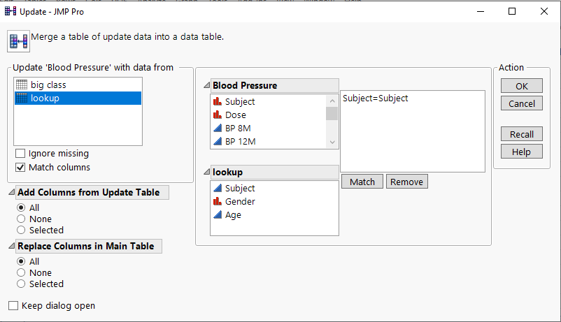

In my opinion, the way to do a Vlookup in JMP is a far easier method.  What is used, is the Update platform
     Tables==>Update
It can do the same function as the Vlookup, or it can easily bring in multiple data columns, based upon multiple matches, such as matching not just on Subject but lets say, on Subject and Dose.  Interactively,
Attached are two data tables.  The first one is the blood pressure table with all of the formulas and Update applied.  The second is the Lookup table referenced in the Update platform.
