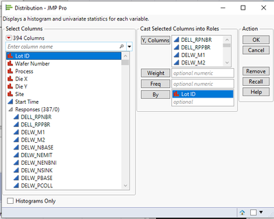

I think using Distribution is fairly easy option. Create Distribution with measurement data as Y, Columns and sample number as By column (using Probe data), if you have lots of data this will be slow and might in worse case crash JMP, so scripting this might be a better option (you could script this same process, use matrix calculations or some other method).
After you have your Distributions, hold down ctrl + alt and click red triangle next to one of the distributions and disable everything else besides Summary Statistics (should make this a bit faster) and press OK:

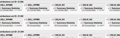

Now we have this beautiful distribution report:
Right click on one of Trimmer means and choose Make combined data table:
You should end up with datatable with 5% Trimmed Means for all parameters and groups:

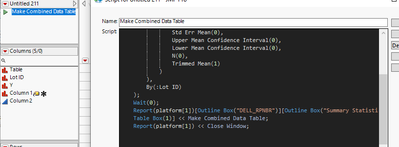

For some reason, JMP wasn't showing me the source script when I made the table manually. This worked perfectly.
jthi
Re: Formula for trimmed mean
JMP should be able to help you with that. Create the table manually and check the table script from result table:
