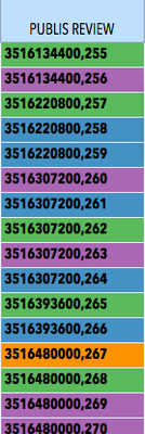

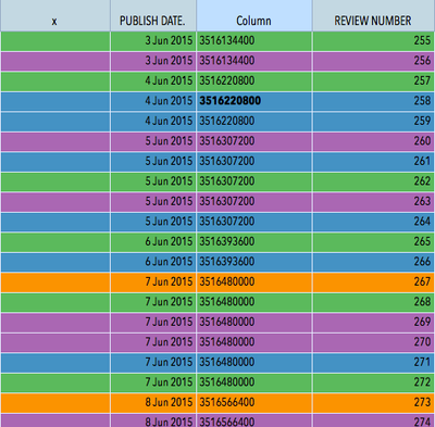

I am fine with it but I can't do my version where the data is numeric (date/time):
Here is the result when I
Char(:PUBLISH DATE.) || "," || Char(:REVIEW NUMBER)
pmroz
Re: Formula for combining columns?
For dates use the format command, with your favorite JMP date or datetime format.  Here's an example:
Format(:Publish Date, "m/d/y") || "," || Char(:Review Number)
