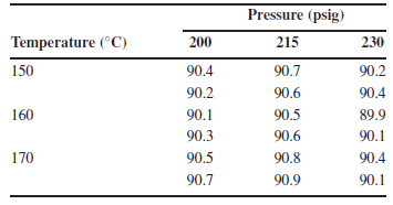

I'm trying to fit a model for a two-factor experimental design (2 factors). This is Problem 5.4 in D.C Montgomery book (Design and analysis of experiments 8th ed. Chap 5.The yield of a chemical process is being studied. The two most important variables are thought to be the pressure and the temperature. Three levels of each factor are selected, and a factorial experiment with two replicates is performed. The yield data are as follows:
The solution of this problem is met when  Temperature and Pressure are set at "Nominal". I was expecting to set them at "Continous" but if I do that the ANOVA is wrong.
1) Why do I need to set factors to "Nominal" instead of "Continous" to get a proper ANOVA and fitting estimates?
2) If I want to find a regression model from the data, I need to set Temperature and Pressure at "Continous". Why?

There is more than one way to analyze data sets.  Not necessarily "wrong".  In the ANOVA approach, what you are estimating is the effect of each term in the model.  For the two factor experiment you are referring to, each factor has 2 degrees of freedom (or 8 for the model effects), so the model is:
Y = T + P + TP + Error
If you use regression for analysis, you will be able to assign those 2 degrees of freedom for each factor to the linear and the quadratic effects:
Y = T + P + TP + T*T + P*P + E
