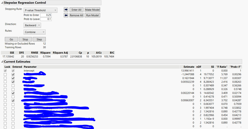

When you put interactions into the fit model and then perform the "stepwise" personality. You can remove extraneous interactions using the pValue threshold. See below:

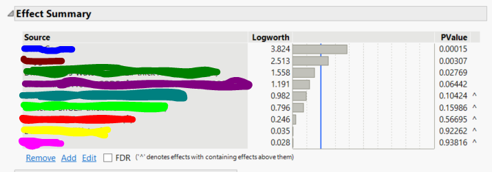

Here I have the regression set to remove any interaction that has a Pvalue more than 0.1.  However, when I go to make the model with "standard least squares" personality and "Effect Leverage" Emphasis, I get Pvalues above 0.1 for the same interactions that I just saw in the Regression Control. Why? See below:

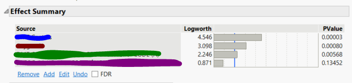

Additionally, when you remove the worst of the interactions (based on highest pValue), some of the other interactions get better pValues--to the point of becoming statistically significant, when before the deletion, they were not. I assume that the interactions removed do have some effect and that effect must then be redistributed to the other variables, but I don't understand why it makes such a big difference or what is really going on. See below (yes, matching colors indicate the same interactions in the two "effect summary" images).
