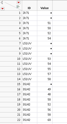

I am trying to select the first value for each unique ID and save it to a new column. For instance in the example below, the 2k71 would be 51 and 3SJ42 would be 49. How would I write a formula to find only the first value for each unique ID?

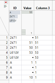

Re: First Value for a Unique ID
If you want the value to be also in rows which have missing value this could work:
ids = Loc(:ID << get as matrix, :ID);
first_val = Min(Loc Nonmissing(:Value[ids]));
:Value[ids[first_val]];
I strongly suggest that you take a look at Loc() function from Scripting Index and possibly run the formula in smaller parts so you understand how it works. There are most likely easier ways to do this, but I like using Loc().
-Jarmo
Here is one way that:
  • first finds the first finds the smallest row with and without missing values (red box)
  • excludes those missing values returning the row for each ID type (purple box) and then
  • gets the value for that row.
Here is a script you can run to recreate this column with a few steps along the way:
