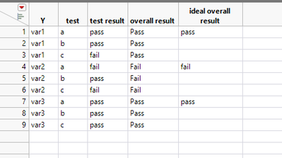

Fill column once per group without repeating values with JSL
Hi!
So I have the below data table.  The individual test results are in the "test result" column and indicate if the respective y passes test a,b, and c. The "overall result" column indicates a "pass" if 2 or more of the tests (a,b,c) pass.
I was able compute the overall result with a formula, but what I would like to do is get a list that says the result once per Y variable-- i.e. overall result = "pass, fail, pass" like the ideal overall result has. Any ideas??

Just need a small change to your formula.
New Column( "overall result",
	Formula(
		If(
			Col Cumulative Sum( 1, :Y ) > 1, "",
			Col Sum( test result == "pass", :Y ) >= 2, "Pass",
			"Fail"
2 REPLIES 2

Re: Fill column once per group without repeating values with JSL
Additional option (I usually do these type of "shifts" using Row() == Col Min(Row()) or Row() == Col Max(Row())).
Names Default To Here(1);
dt = New Table("example 4",
	Add Rows(9),
	Compress File When Saved(1),
	New Column("Y", Character, "Nominal", Set Values({"var1", "var1", "var1", "var2", "var2", "var2", "var3", "var3", "var3"})),
	New Column("test", Character, "Nominal", Set Values({"a", "b", "c", "a", "b", "c", "a", "b", "c"})),
	New Column("test result", Character, "Nominal", Set Values({"pass", "pass", "fail", "fail", "pass", "fail", "pass", "pass", "pass"}))
dt << New Column("Res",	Character, Nominal, Formula(
	If(Row() != Col Min(Row(), :Y),
		"" // not first row fir Y group
	, Col Sum(:test result == "pass", :Y) >= 2,
		"pass"
	, // else
		"fail"
-Jarmo
