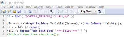

I recently updated from JMP 16 -> JMP 17 and the following script on line 5 is failing for me. I am not seeing the ' === below === ' below my graph builder. This used to work in JMP 16.

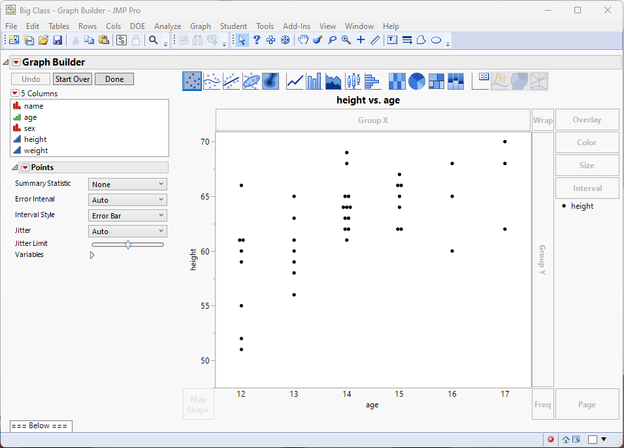

jthi
Re: Failed to add text below Graph Builder using script
It does get added, but the place is something which isn't shown
Depending where you want to see the text, you can append it into other displayboxes in within the window. Graph Builder Outline box like Jim suggested or within the ListBox

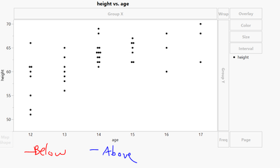

I do want to add it right below the heading of the x-axis (as shown in the screenshot below).

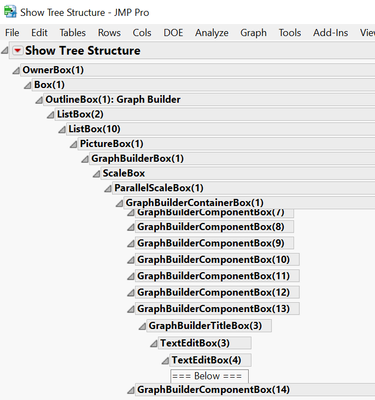

I tried looking at the Tree Structure and it didn't work when I appended right below the 'Age' TextEditBox.
