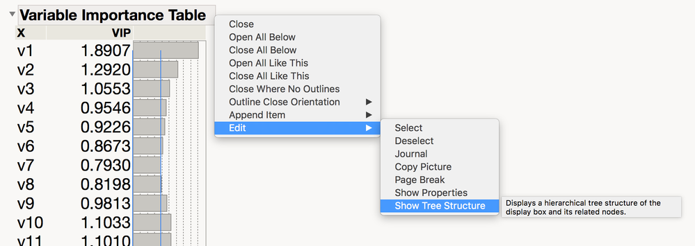

You can find the report section of any output by right-clicking and select Edit-->Show Tree Structure.
I used the Baltic sample table for this example.
Edit--Show Tree StructureEdit--Show Tree StructureTableBox(7)  VIP tableTableBox(7) VIP table
I joined the tables using Tables --> JMP Query Builder.
