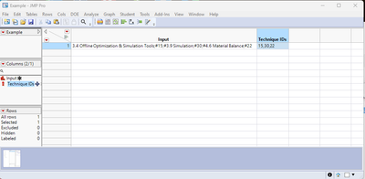

Hi! I have data from a SharePoint which we use to (among other things) to track what tool/technique(s) was/were used to solve a problem. This includes JMP, BTW.  The data (in one column) follow this type of ;-delimited formatting:
<technique description>;#<technique ID>;<technique description>;#<technique ID>;<technique description>;#<technique ID>...
3.4 Offline Optimization & Simulation Tools;#15;#3.9 Simulation;#30;#4.6 Material Balance;#22
Each row in the table (problem solved) can have one or more <technique ID>. Sometimes the <description> starts with #, sometimes not. But <technique ID> is always preceded by #.
I would like to parse the string for the <technique ID>'s  and format for Multiple Response analysis: 15, 30, 22 (above example).
  1. There are ~100 <technique ID>, so creating ~100 sparse columns seems wasteful.  Is the approach used in the Sample Data file Failures3Delimited.jmp the most efficient way to approach this problem?
  2. I've started to learn REGEX and have been able to find one occurrence of <technique ID>, but not all. Do I need a loop? Some other way to do this?
Thanks. Using JMP17.1 Pro.

@hogi wrote:
... complicated split first-second ...
actually -  less complicated than I thought :)
New Column( "IDs",
	Character,
	"Multiple Response",
	Formula(
		splitItems = Words( :Input, ";#" );
		Concat Items( splitItems[2:: N Items( splitItems ):: 2], "," );
... and one of the next versions of Jmp will make it even easier:
https://community.jmp.com/t5/JMP-Wish-List/new-slicing-options-for-matrices/idc-p/614326/highlight/t...

Here is a potential solution that I came up with:
Here is the formula I used
i = 1;
string = "";
While( Word( i, :Input, "#;" ) != "",
	theWord = Word( i, :Input, "#;" );
	If( Is Missing( Num( theWord ) ) == 0,
		string = string || "," || theWord
	i++;
Try( Substr( string, 2 ) );
Jim

Very elegant - instead of a complicated split first-second (twice the same delimiter) or some which part is the TEXT, just:
find the NUMBERS :)
Let's hope there is no ID #30-2  ...
or a description: 42
New Column( "IDs",
	Character,
	Formula(
		Concat Items(
			Transform Each( {theWord}, Words( :Input, ";#" ),
				Char( Num( theWord ) )
	Set Property( "Multiple Response", Multiple Response( Separator( "." ) ) ),

Thanks, Jim! I was thinking that some sort of loop would do the trick, with or without REGEX. Hope that you are well!

Won't go suggesting using JMP's Character Pattern as it is fairly difficult to understand (at least all the different functionalities) but I did manage (maybe) to do this using it
Names Default To Here(1);
str = "3.4 Offline Optimization & Simulation Tools;#15;#3.9 Simulation;#30;#4.6 Material Balance;#22";
idlist2 = {};
resval = "";
Pat Match(str, Pat Span("#") + Pat Regex("\d+?") >> next_id + Pat Regex("(;|$)") + Pat Test(
	Insert Into(idlist2, next_id); resval = Concat Items(idlist2, ", "))
show(idlist2, resval);
here is example using it in formula
dt = New Table("Untitled",
	Add Rows(1),
	Compress File When Saved(1),
	New Column("Column 1",
		Character,
		"Nominal",
		Set Values(
	New Column("Column 2",
		Character,
		Formula(
			idlist2 = {};
			resval = "";
			Pat Match(
				:Column 1,
				Pat Span("#") + Pat Immediate(Pat Regex("\d+?"), next_id)
				+Pat Regex("(;|$)") + Pat Test(
					resval = Concat Items(idlist2, ", ");
			resval;
		Set Property("Multiple Response", Multiple Response(Separator(",")))
-Jarmo

hogi: Thanks for both your submissions! I'd used Words() before, but didn't think of it because early on I convinced myself that I would have to pursue a REGEX solution. This solution is very elegant! I need to read up on Concat Items()...
Jim/Jarmo/hogi: you have showed the global power of the community! I now sit in Kuala Lumpur. I posted this first thing my morning when you were likely about to sleep/already sleeping. I got a solution from you by my late afternoon. Thank you again!
