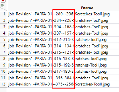

Hi,
I have a table1.jmp as atteched. How do I extract the X and Y as circled in the red box? The X and Y values can sometimes be negative. For example, the XY values from the 1st row is -280,-396. The XY values from the 2nd row is 284,-228.

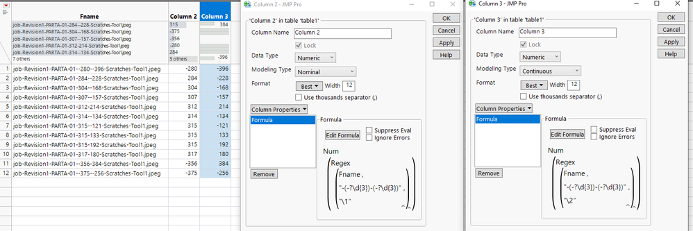

Re: Extract String which has positive and negtive numbers
Regex can also be an option (https://regex101.com/r/5fgzrx/1 for partial explanation on how this works)
Num(Regex(:Fname, "-(-?\d{3})-(-?\d{3})", "\1"))
change "\1" to "\2" for Y
