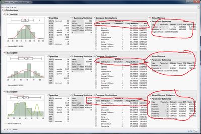

Hello,
I watched a recent video (Using JMP® to Assess Risk in Financial Predictions by Using Monte Carlo Simulations - YouTube)
At the end of the video a gentleman asked the very question that I had: If you have a LOT of distributions how do I get the results from this window into a table to add rows and thus make a Monte Carlo. I have daily temperature data that I'd like to have a MC done on per day to construct a daily distribution.
I can go about this manually as the video shows - but I know there must be a quicker method.
Any help on this would be most appreciated!

Re: Exporting Fitted Distribution Results to a New Table
You can right click on any report table and choose "Make into Data Table" or "Make Combined Data Table" to get the results into a data table.
I think I need some more details about exactly how you want to do your simulation to help you with how to take that information into the simulation.
-Jeff
-Jeff
wzimmerman
Level I
Hi Jeff,
I'm looking to nab the distribution formulas. For example if I open a table and make a formula in a column: Random Normal (x, y) and then add rows I'll end up with a Monte Carlo simulation of sorts as it will pick a random number along the distribution I just specified.
If I could do that or something similar by taking the distribution formulas or results to another table to create a distribution for each day of data.
The video shows the way to do this with few variables and at the end of the video someone from the audience asks - well how do you do this with many variables. The class decides to do this after the lecture and the video ends without answering it...
