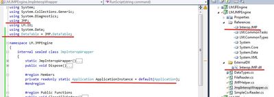

Let me illustrate my question to be clear.
You can see that I have Interop.JMP.dll included into solution, referenced in solution. As a result compiler recognizes JMP data types, such as JMP.Application and JMP.DataTable.
But this dll is from old JMP, not JMP 11 PRO that I am going to use now.
