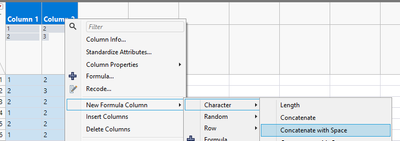

I assume both of your columns are character columns, you can select both of those columns, right click on column header and create new formula column with concatenate
Then select one of those rows which has "3651 3651", right click, select matching cells and finally delete rows

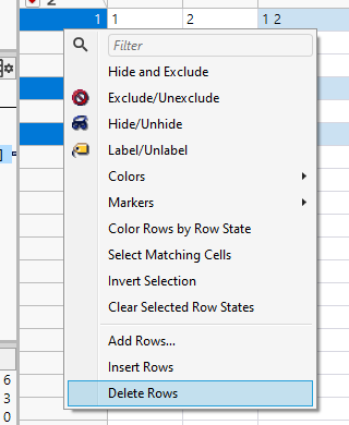

The approach that I would use is similar to Jarmo's, however it does not require the creation of a new column.
  1. In row 1 for the column named [final], click on it's cell that has the value 3651.  The cell will then be highlighted
  2. In the same row, go to the Column named [max], hold down the CNTL key and click on the cell.
  3. Both cells will then be highlighted(selected)
  4. Move the pointer(mouse) the rowstate column for row 1, which will also be highlighted(selected)
  5. Right click on that cell and choose "Select Matching Cells".  All rows that have values of 3651 in columns [final] and [max] will be selected.
  6. Right click once again in the rowstate column for one of the selected rows, and choose, " Delete Rows"
Jim

Sounds like you got what you needed.  But in case someone comes here actually trying to just delete every other row, here's another way:
Create a new formula column with this formula:  Mod(Row(), 2)
Then click either the "0" or "1" in the header graph and then select Rows -> Delete Rows.
jthi
Re: Editing rows in a large data table
Similar thing can also be done by initializing data in new empty column
and you will end up with column with values 1,2,1,2,1,2,1,2.
-Jarmo
