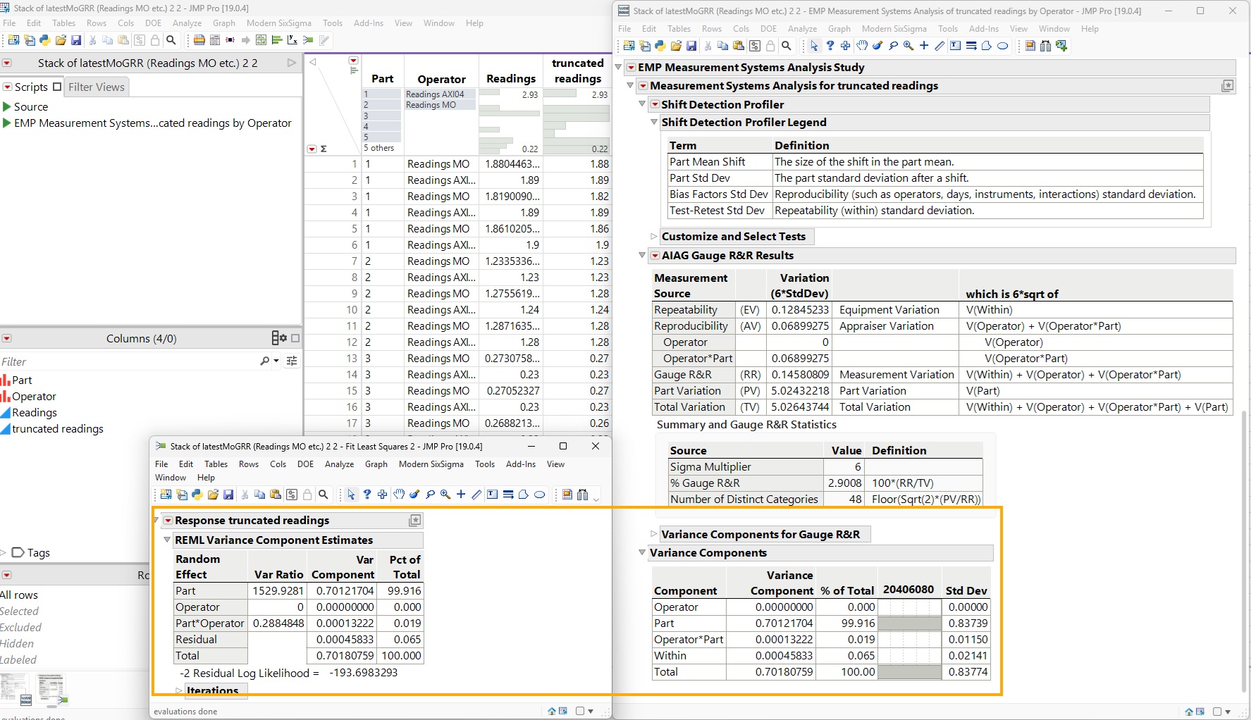

EMP GRR : AIAG reproducability
using ANOVA from Fit Model and then GRR EMP + AIAG GRR , we are matching the Within Repeatability Variance and Part to Part Variance but :
the Reproducability Variance is expected to be zero ( actually it was negative )
Can we get help to understand from where the Reproducability Var component is worked out ?
Please use the truncated data in the files
2 ACCEPTED SOLUTIONS
Re: EMP GRR : AIAG reproducability

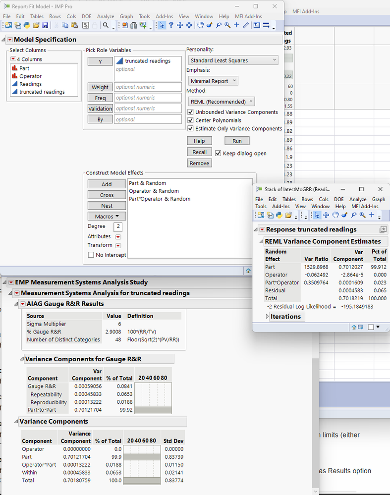

Thanks @carloaz. In Fit Model, if we uncheck the Unbounded Variance Components Option, then this will allow that negative variance estimate for Operator to be bounded at zero, and the results will match identically with what you for the Variance Components in the EMP Gauge R&R Report (see attached).
Here are the results which show complete agreement between Fit Model (Fit Standard Least Squares with REML) and the EMP GRR Platform, where "Residual" is equal to "Within" (see attached).

Based on this Quality and Process Methods > Measurement Systems Analysis > Launch the Measurement Systems Analysis... I would assume it is using REML for variance part of the analysis. How did you model it in Fit Model?

ok issue solved :
Although Var Operators is negative , it is added to Var opx parts to be then var comp , the numbers do match and many thanks to all contributors
